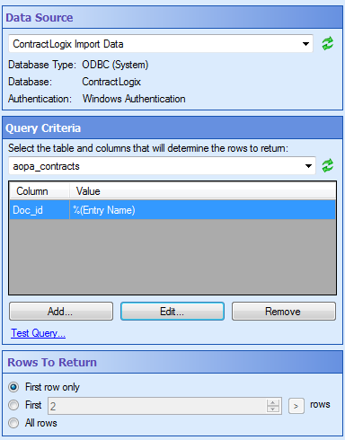

I was using the global token %(Entry Name) when I should have been using the token from the "For Each Entry" step: %(ForEachEntry_CurrentEntry_Name).
As soon as I switched that token it worked as desired.

Here are a couple of screenshots for more background.
This is how the data source and query are configured:

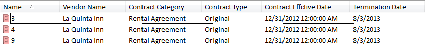

Here is how the documents are named and you can see how it is using the same metadata for the three different test documents. All three of these are different contracts with different vendors.
There is a column in the database for Doc_id which is what I have the lookup using to return the correct row. The doc_id is the same value as the "Name" of the document in LF. However, it seems that it is using whatever the first entry is and not using the "For Each Entry" to get a new doc_id and run the query.
