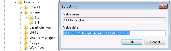

This is available in Laserfiche 9.1.1 SP1 and later. Please review KB 1013480 where it states
You can now configure the registry to stop the Laserfiche Server from automatically attempting to republish a service connection point in order to prevent client programs from being able to automatically detect the existence of the Laserfiche Server instance. Using the Windows Registry Editor, browse to the HKEY_LOCAL_MACHINE\SOFTWARE\Laserfiche\Engine\8.0 key. Modify the value of SCPBindingPath by deleting the LDAP:// protocol prefix. (114274)

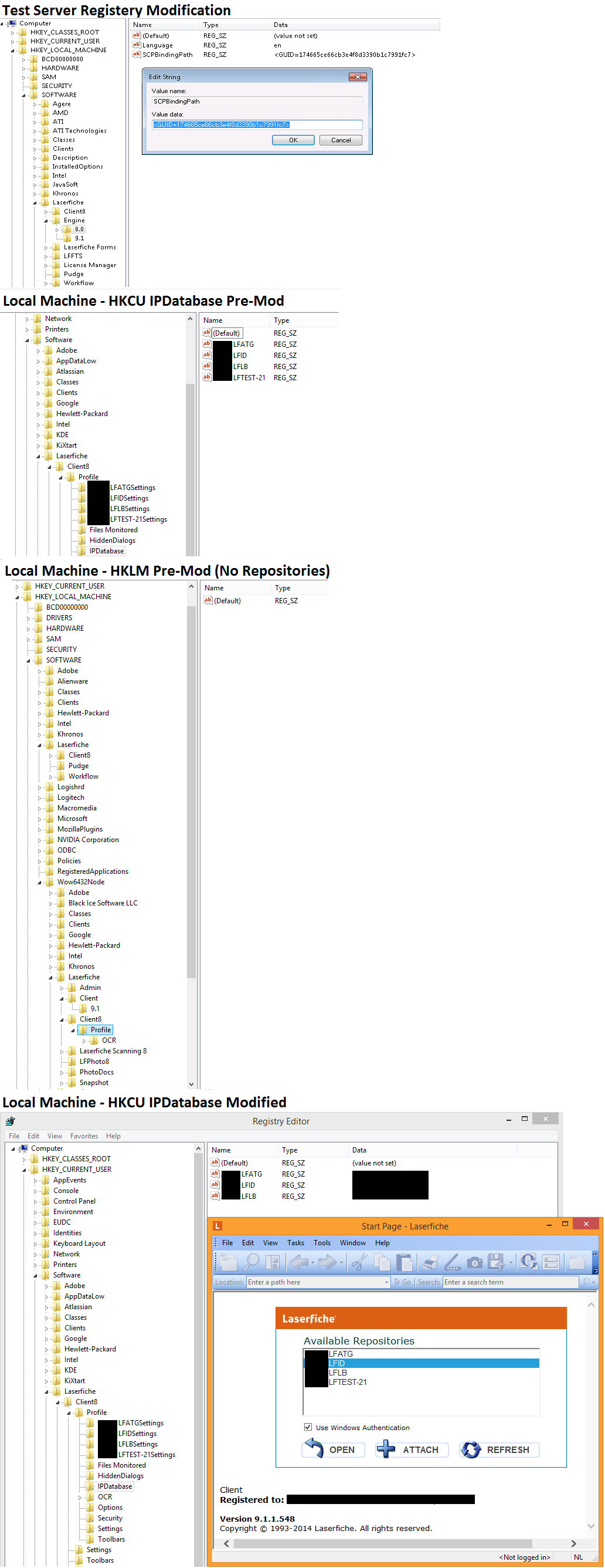

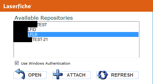

replied on October 23, 2014 • Show version history
Alexander,
I deleted the LDAP:// protocol prefix from the HKEY_LOCAL_MACHINE\SOFTWARE\Laserfiche\Engine\8.0 the Registry on our Test Server. I have also tried deleting the GUID. Our test repositories are still being broadcast. I have restarted the Laserfiche Service on the Server and also restarted my local client. You can see that our two test repositories  on our test server are still broadcasting to the client.

replied on October 28, 2014 • Show version history
Miruna,
I have also deleted the repositories on my local machine under the paths you specified. As my results are shown below, the repositories are still seen after restarting my local Laserfiche Client.
