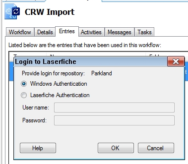

I publish the workflow, and run the workflow.  Upon checking the Entries tab in the workflow, I receive a pop up "Login to Laserfiche".  By default the dot is at Windows Authentication.  I switch to Laserfiche Authentication.  I enter the local user account and the process runs.  I have checked everything I can think of.  Why does the workflow revert to Windows Authentication?

When looking at the instance details, on the Entries tab, we require the user to log in. This was done for security purposes as some users may be allowed to see how the workflow went, but not where the document currently is. The user can specify a LF user or Windows Authentication (no ODBC is involved). The user can specify the same information as the connection profile, but they are not expected to. This information is not saved and, as mentioned above, this connection to LF will time out and disconnect itself if not used for a bit. In your case, since you're also designing workflows, you already know the password for the connection profile, so that's probably why it feels somewhat weird to be asked for authentication again. The feature was designed with users who may have less rights to WF/LF in mind too. This connection defaults to Windows Authentication since that is the more common way of logging into Laserfiche as a regular user. Being prompted for authentication in the Entries tab in the instance details is the expected behavior and not an indication of any connection issues between WF and Laserfiche or between WF and 3rd party data sources.

The instance details do not save the authentication nor do they use the profile connection. So you have to log into access the entry information. The connection goes idle and times out if not used for about 2 minutes.

It sounds like there's a little confusion here. The Entries tab in the workflow instance details merely displays a list of what entries have been involved in your workflow, logging in to the Entries tab has NO impact on whether or not your workflow will run.

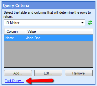

To test the specific query of your Query Data activity, you can use the "Test Query" button from the activity's properties:
If your query is returning the correct results and your workflow still isn't producing the desired results, I would recommend looking at the workflow instance details (the same place where you were accessing the Entries tab) but focus on the Workflow tab and the Messages tab which will show information regarding what steps happened during the workflow and any error/status messages that came up.
replied on April 30, 2014
Aaron,
thank you for a well thought out reply.  Unfortunately, I have checked and rechecked this connection.  It is working as intended.  When I click the drop-down box the tables columns all populate.  When I click "Test Query" and remove the token to use an actual value; 1 record is returned.

Thank you for the information on the Entries tab.  The other day, I was constantly being prompted for the username and password.  Today everything seemed to be running smoothly.  The "localhost" error was gone.  I only logged into the Entries tab the one time today.
