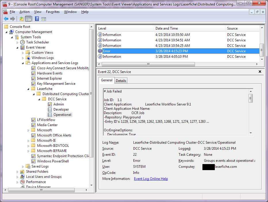

DCC logs to the Application and Services log.

You can use the Web Administration Console to view DCC jobs. Clicking on a specific job ID will give you additional details and even show you the current task progress. If you see that it's stuck on a task, then check the "Machines" node in Web Admin and confirm that there are workers available that can perform tasks.
As for where you can check for additional information about jobs, go into the Event Viewer and look at the DCC logs. DCC has it's own set of event logs which are under Applications and Services Logs > Laserfiche > Distributed Computing Cluster > DCC Service and you will see three logs: Admin, Developer, and Operational.
For an issue with the jobs themselves, you'll want to look at the Operational and maybe Developer logs.
