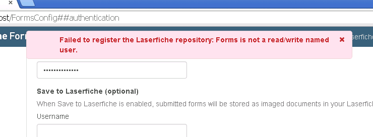

replied on August 22, 2018
We are on 10.3.1.553 and this funtionality does not seem to be working. Forms has yet to establish a communication channel as the FORMSUSER$. Thus when I remove the license that it was using during development to allocate to an end user forms can no longer save to the repository. Event Viewer claims that forms no longer has a read/write license. So what would be preventing the switch over?
