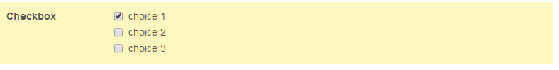

asked on April 25, 2014
 I'm looking for a way to set a checkbox/radio button to a default value.  I have limited knowledge of Javascript so I'm hoping I can do this without code.
Thanks,
Nate

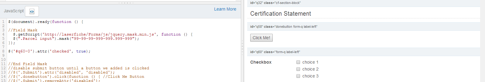

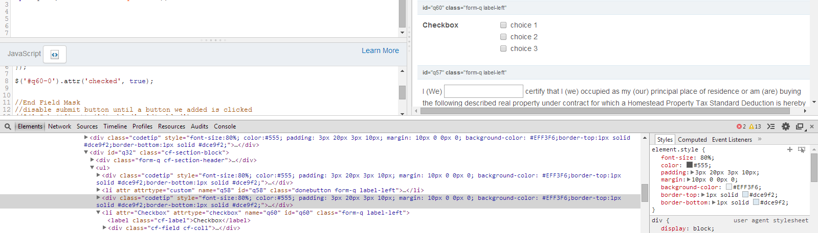

replied on April 25, 2014
Kenneth,
I tried the code you gave me and I think my mistake is in the fieldID area.  I've attached a couple of screenshots to show you what I have.  Let me know what I'm doing wrong.
Thanks,
Nate
