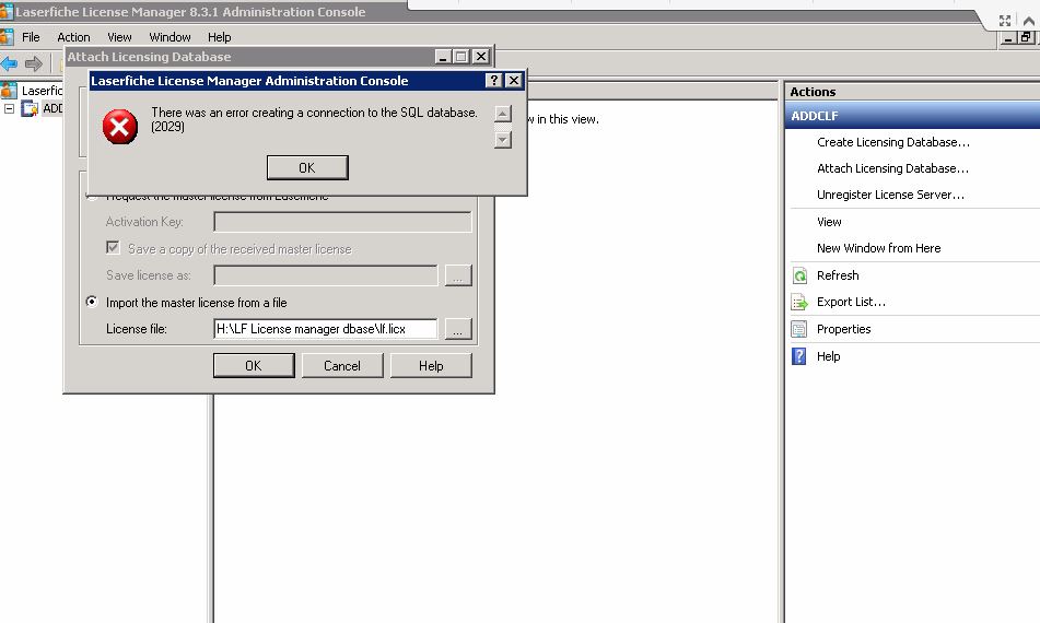

i am trying to attach license manager after  de-attaching it, and i got this error when i attach database
There was an error creating a connection to the SQL database. (2029) ? although laserfiche sever is communicating with sql server

What account is LF License Manager Service using? Does it have access to the SQL database?

we are using domain administrator user, i verified the below;
1- same user able to login to sql server
2- laserfiche server can ping and communicate with sql.
i solved this, i found license lf.licx, is corrupted, although i deactivate and activate three times without any issue.
i figured out the issue by chance only, when i viewed the event-viewer log, it was mentioning the license file is corrupted.

this had been solved, license file was corrupted although i generated many times, i deactivated again then create it from different machine .. remote activation.
