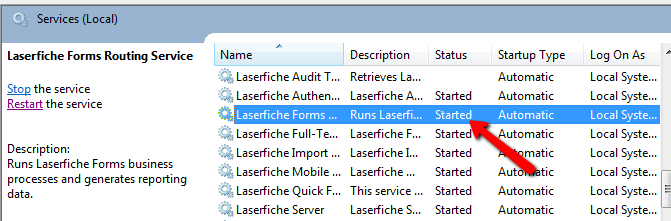

This may sound like a silly question but can you confirm that the Laserfiche Forms Routing Service is started?
replied on April 23, 2014
It is not.  When I try to start it manually, i get a message say that it started and stopped, and that sometimes this is normal operation.

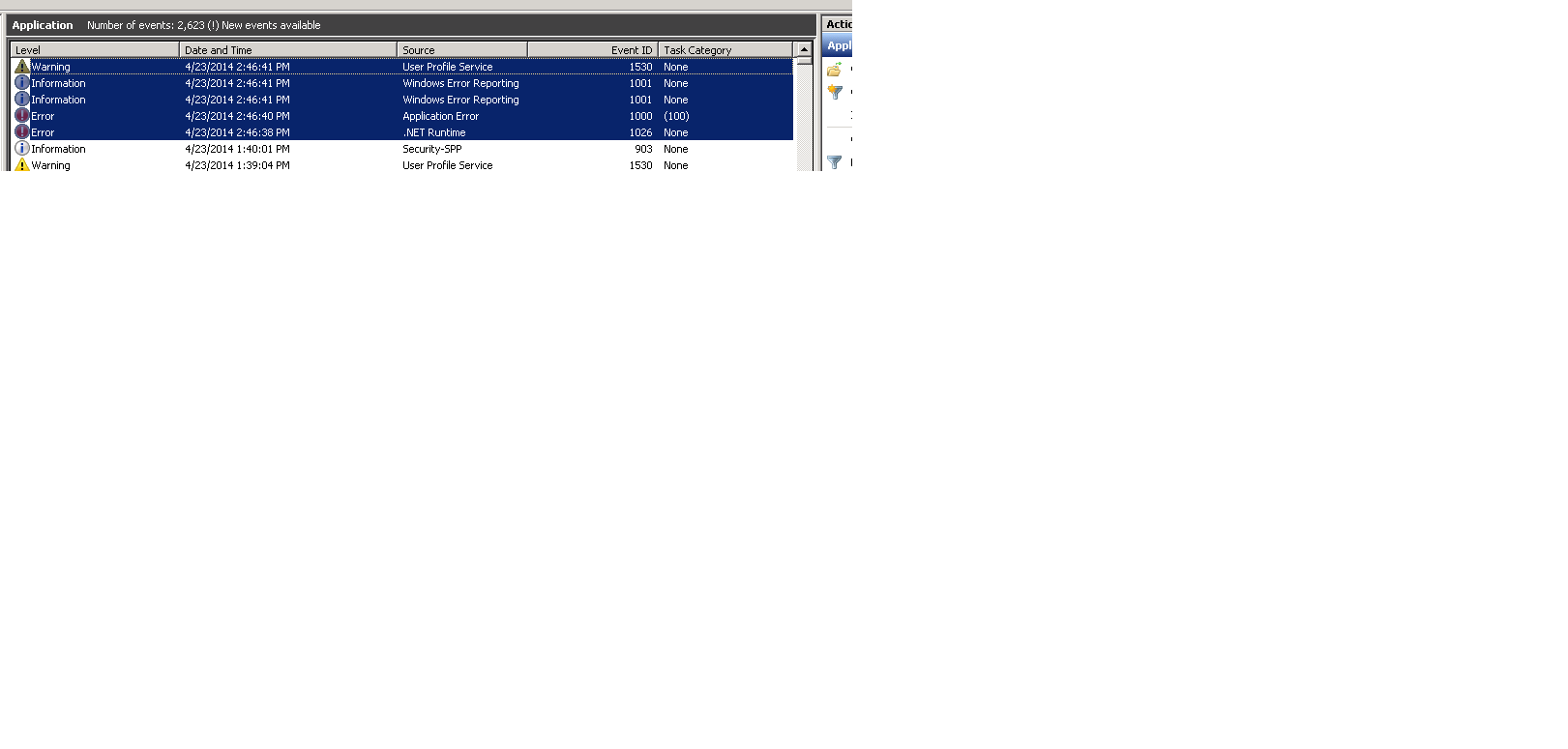

In the application event log I see::

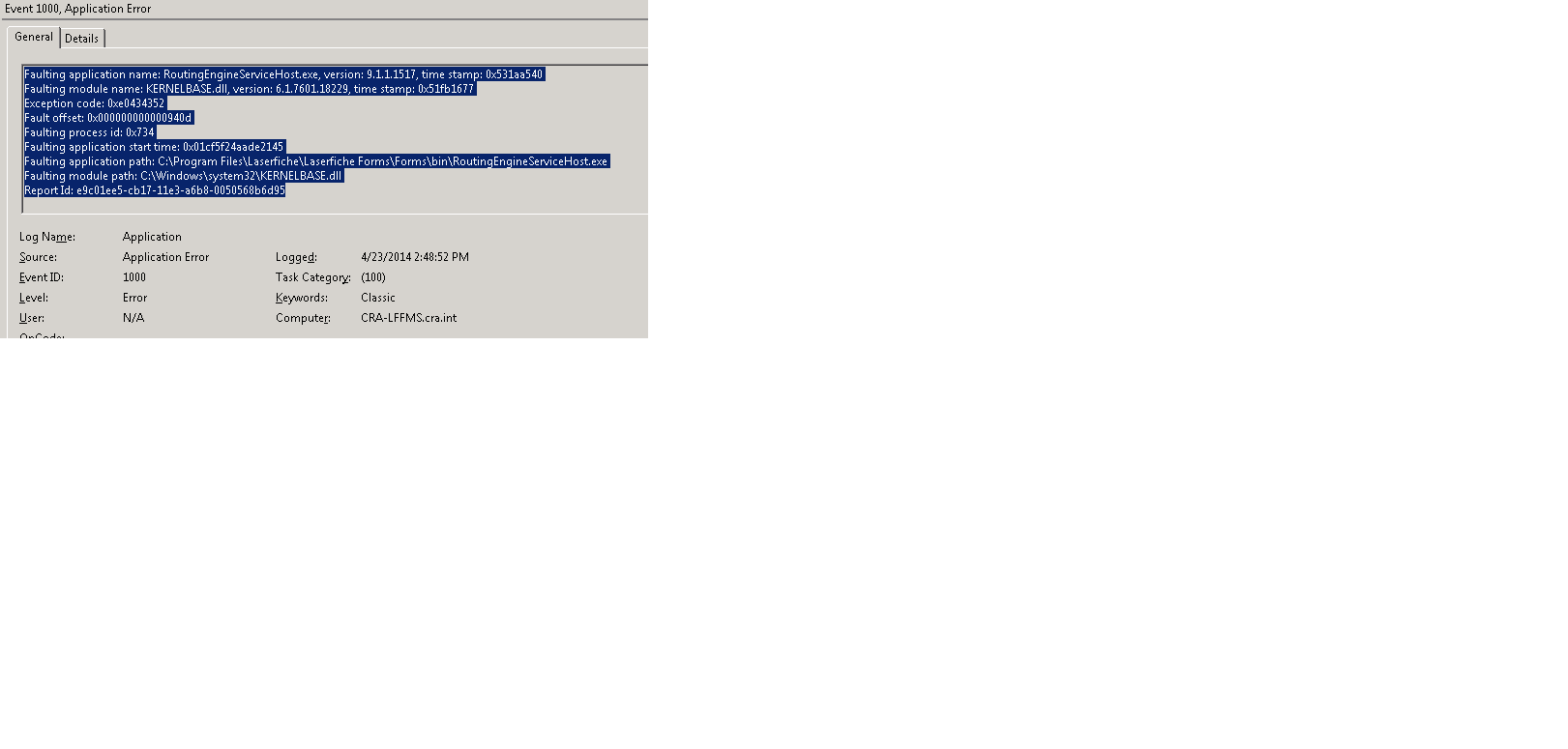

Can you post the details of the "Application Error" listed in your Event viewer screenshot?
Here you go.   Let me know if i need to post more.
