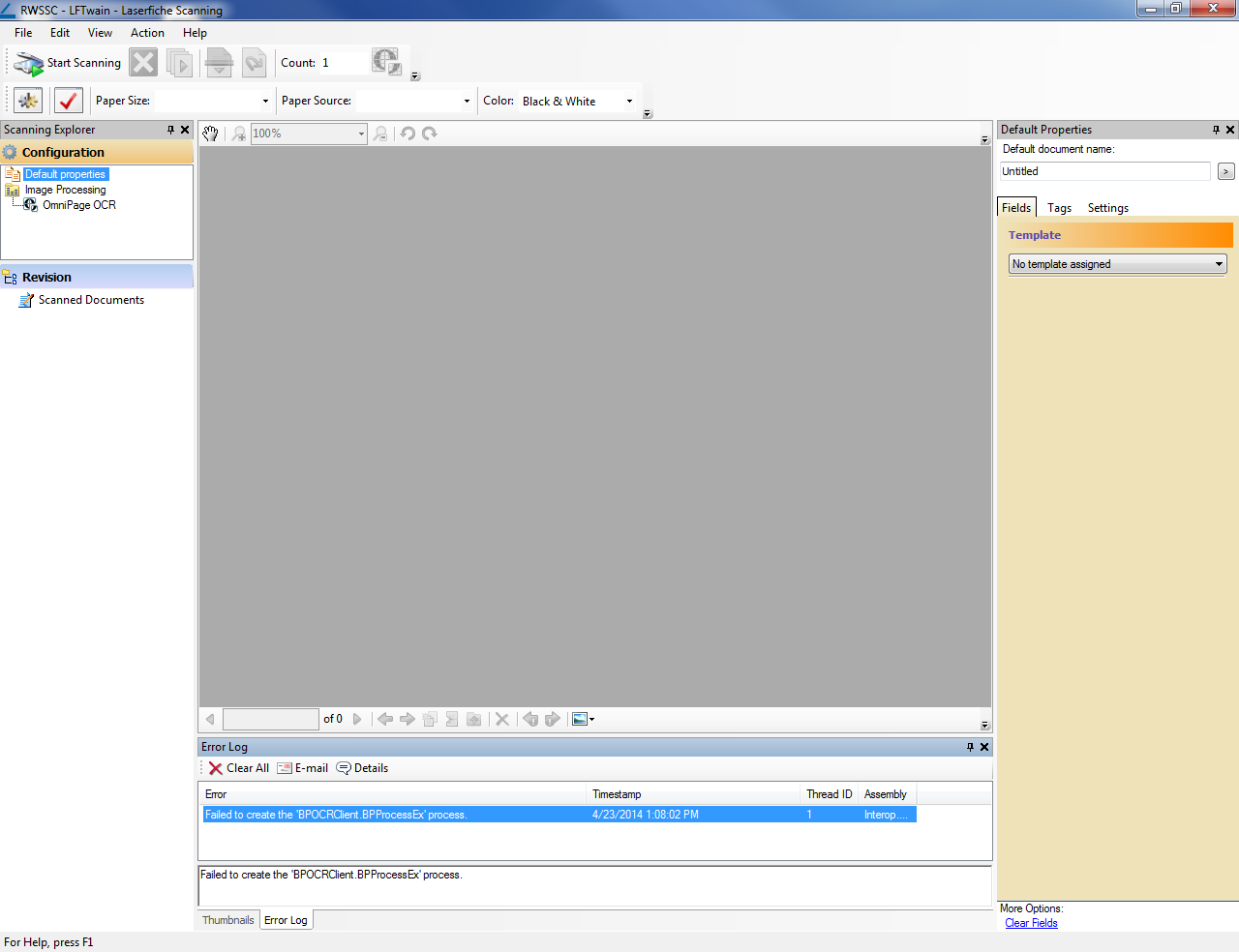

Press Ctrl+Shift+E to open the application errors pane. Are there any errors listed?
replied on April 23, 2014
Attached is the screen when I try and Scan.
Message says "Failed to create the "BPOCRClient.BPProcessEx' process"

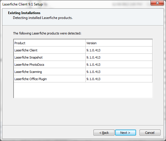

Here's the message that comes up when I hit Modify Program.
Matches the "About" screen, as well.
Can you try uninstalling the 9.1.0 Client suite, reboot the PC, and then reinstall? See if that address the matter.
As a side note, I'd recommend upgrading to Laserfiche 9.1.1 when you get a chance instead of staying on 9.1.0. This is for the Server, Client, etc.
