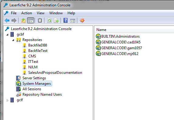

replied on July 13, 2015
Try adding the current windows user to the System Managers node in the Admin Console
