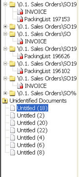

My immediate problem is with documents sitting in the Document Manager that I have to do something with. I have unidentified Packing Lists that I can right-click and assign to a document class but when I do that they go somewhere and I'm not sure where that is. I also have documents above the unidentified section that have icons that look like a document with a red circle in the bottom right corner. I've been told to get those unidentified Packing Lists into a specific folder in the repository with the matching Invoice and Sale Order. I'm not sure at this point how to get that done.

Maybe a screenshot will help us out.  I am not sure what the red circle icons you are referring to.  When you assign a document to a class it will move itself out of Unidentified and into the Document Revision area.  Depending on your class settings it could go to a folder with lookup, zonal ocr, or pattern matching tokens.  Point is, when you manually assign it a class it moves up to the Document Revision.  It does not delete it or store it so it should be there.  You can manually change the path once you find it so you can store the docs and then get them.

I have attached a screenshot of the Document Revision pane. I cut off the top to hide the customer name.
replied on April 15, 2014
Those red icons generally mean that there is a required field that is not filled out. If the document was not identified originally and you classified it, there will be no data to fill the fields. Also, when you classify a document, it goes from the unidentified node to slotting into one of the folders up above.

From your screenshot I am guessing that the ones you assign to the class manually are located right above unidentifed in Sales Order\SO% (expand the folder).  When you assign a document to a class manually and non of the page processing are reading it is going to assign it the tokens instead which is why the folder is called SO% and not SO19 like the others.
The red exclamation points are just errors on the document.  Select them and then over on the rights see what's up.  It could be a missing required field or some other metadata problem (not the correct format, etc).

You are correct about the unidentified documents moving after the class is assigned. I can now see what data is missing for each of the documents. Do I try to manually fix these and put in the missing data or is there a way to fix this?
replied on April 16, 2014
Once a document is moved into the Identified documents area you are going to have to manually fix the problems.  Fill in the path, change the name, fix the metadata, etc.  Another way is to delete them and scan them again.  If you do this you may get the same result so you would need to change/fix the zones.  This is one of the many reasons us as a VAR and our clients do a barcode and lookup process instead of zonal OCR.  The accuracy and consistency is just not there (in our situations).
