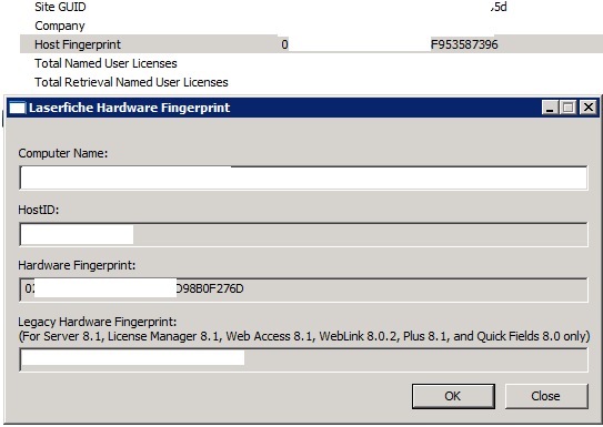

replied on June 25, 2015 • Show version history
Is this the reason that after move, the Host Fingerprint (shown under DB properties of License Manager) are different then the Hardware Fingerprints (gathered using show hardware fingerprints utility) BUT the license Manager is working all fine and none of the servers registered to this LF LM are complaining?
Does this make sense?
Edit: Added a screenshot.
Further findings, the MAC address for the Windows is hardcoded and I believe this is the reason LF LM is not complaining as the MAC address never changes, even after the move.
Is that correct?
The algorithm was intended to accommodate one or two small changes to allow for minor hardware upgrades without invalidating your license. If you make additional hardware changes, you will likely run into issues at some point and need to deactivate and reactivate.
