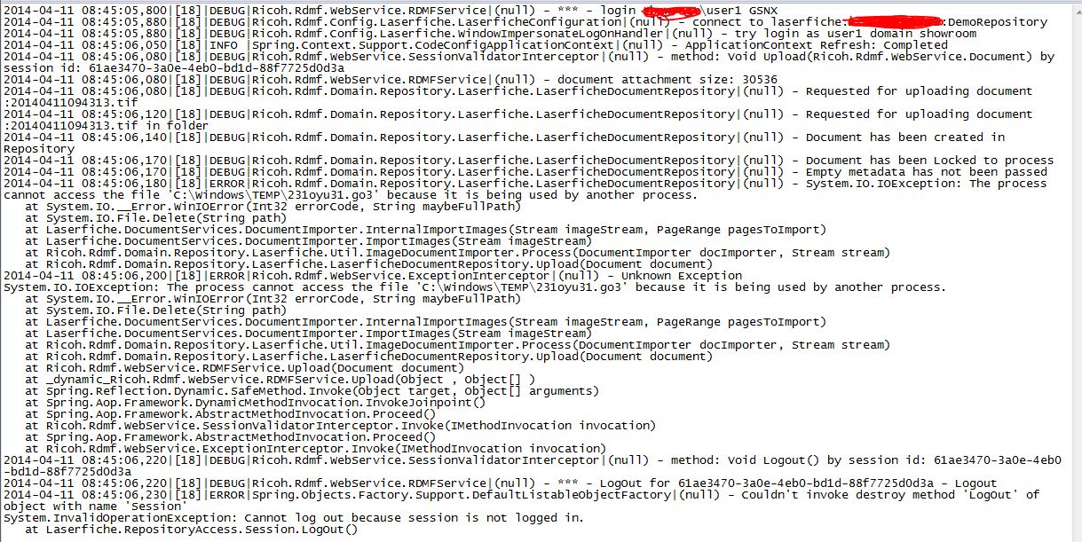

Can somebody help me with the error as shown below?
Error Log:
"System.IO.IOException: The process cannot access the file 'C:\Windows\TEMP\vilgb3yp.s5l' because it is being used by another process.
   at System.IO.__Error.WinIOError(Int32 errorCode, String maybeFullPath)
   at System.IO.File.Delete(String path)
   at Laserfiche.DocumentServices.DocumentImporter.InternalImportImages(Stream imageStream, PageRange pagesToImport)
   at Laserfiche.DocumentServices.DocumentImporter.ImportImages(Stream imageStream)"

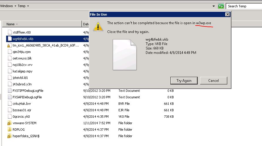

I have restarted the system but I still the same problem.
But when I try to open the file that is causing error as shown my log file. It said the file is open by w3wp.exe. Since my application is web service there is something to do with w3wp.
This tells me that your program is what's locking the file, so it must have something to do with how your program imports. Probably an unhandled exception or something along those lines.
