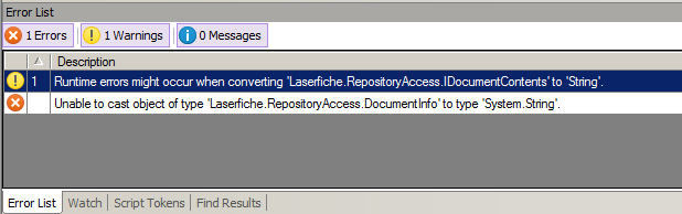

replied on January 5, 2016
I have tried with this code but get these errors
any ideas.
the goal is to get an md5 hash code for each new entry file of any type to eventually find duplicate files.
Try
   'Dim MyDocument As DocumentInfo = Me.BoundEntryInfo
Dim MyDocument As Laserfiche.RepositoryAccess.IDocumentContents = me.BoundEntryInfo
Dim utf8 As Encoding = Encoding.UTF8
Dim tbytes As Byte() = utf8.GetBytes(MyDocument)
dim hash = md5.create
dim oHashBytes As Byte() = hash.ComputeHash(tbytes)
dim oGUID = New Guid(oHashBytes)
dim strTmp = oGUID.ToString.Replace("-", "").ToUpper
SetToken("field_test", strTmp)
Catch ex As Exception
    'Report any errors to workflow...
    WorkflowApi.TrackError(ex.message)
End Try
