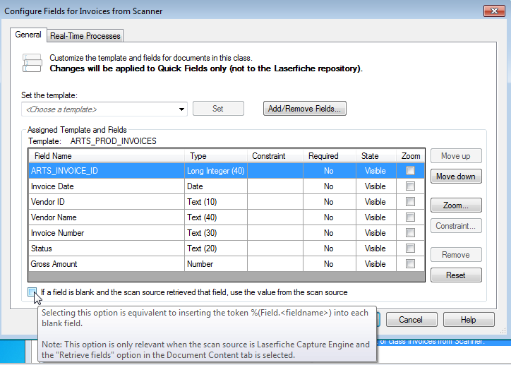

The “If a field is blank” option was checked as this is how it was set under 8.3 and we are running the same session file.  According to the blurb above, it should not be relevant as we’re not using LCE.

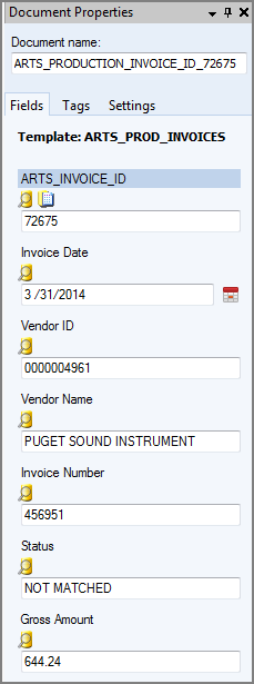

The metadata is found and the fields are populated

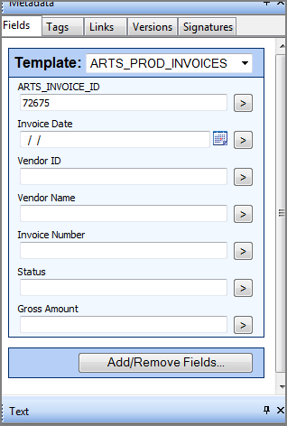

However, when the document is stored, the metadata is lost:

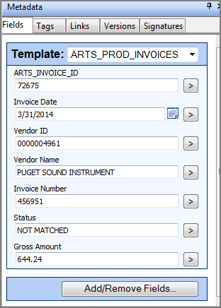

I un-checked the “If a field is blank…” checkbox:  And the metadata is saved correctly when the document is stored:

I had the exact same issue I am using capture engine.  I bring in the docs with no metadata and use zone ocr to populate the check number.  Then I use lookup to populate the rest of the information. It works fine in QF but when I send the Docs it removes the metadata.  If I uncheck the " If a field is blank.... " it works fine.  I am running the most current version of QF.  I was glad to find this post.

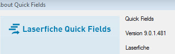

Installing QF 9.0 Hotfix 1013497 resolved this issue for us.
Been troubleshooting this issue today with the same QF process as Kyle’s (barcode>real-time lookup>populate metadata) and can verify that Matt’s recommendation of installing the latest hotfix (currently #1013497) corrected this issue.
Thanks Kyle for pinpointing the setting related to this issue and Matt for recognizing the resolution.

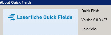

Original QF 9.0 install version:
QF 9.0 version with hotfix:
