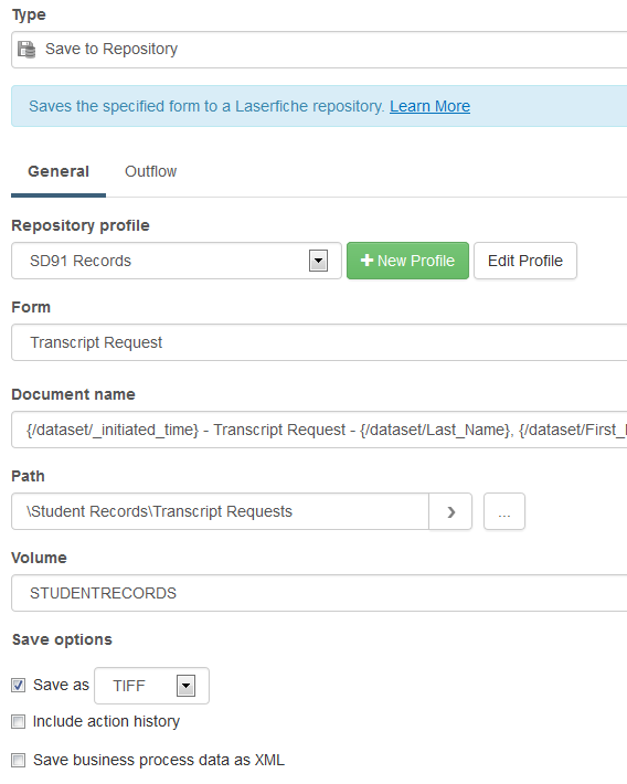

We have a form that was submitted and processed through Forms. It is at the Save to Repository step and says that it is suspended. I have tried to Retry, but no luck. On the Forms server it has the following error:

replied on March 20, 2014 • Show version history
It is actually set to save as a TIFF, so I'm not sure why it would be trying to save as a PDF, it's not supposed to.
