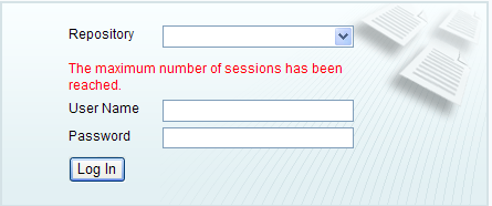

Is there a way we can adjust or add to errors returned by Weblink 8.x? Main concern is "The maximum number of sessions has been reached." error that can occur when logging in. Looking to add some info/instructions to it.

Here is a quick and dirty way to do this. Make sure you place this code right above the </body> tag in the "Login.aspx" file. You can customize this to suite your needs.
<script language="Javascript">
var t = document.getElementsByClassName("LoginError");
var c = t[0].innerHTML;
if (c.match("The maximum number of sessions has been reached.")) {
//add to existing matched error message
t[0].innerHTML += "&lt;p&gt;Please try your request later or contact us at (000)000-0000. We apologize for any inconvience this may have caused.&lt;/p&gt;";
//replace existing matched error message
//t[0].innerHTML = "The maximum number of Laserfiche licenses has been reached. Please try your request again in 5 minutes. If the problem persists please contact support at (000)000-0000";
</script>

Just tested it out. Works well. Thanks Wes!
