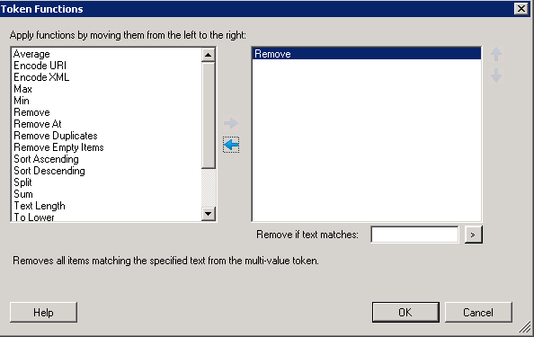

Actually, At least in 9.1,  you have the ability to edit a multi-value token using the "Token Functions".
Specifically, there is a "Remove" function now available to you that will allow you to input a token value that will remove the value specified from the token you choose.
