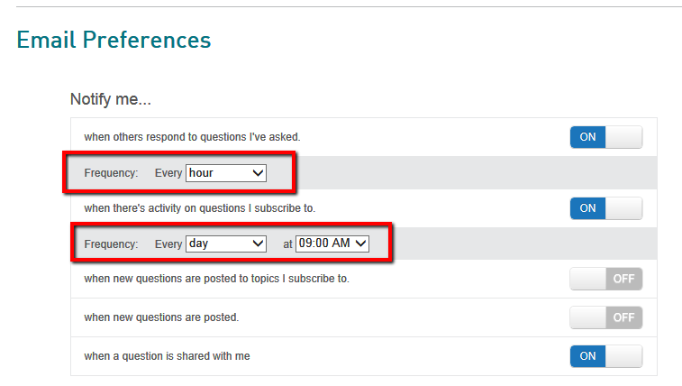

P.S. For some strange reason I was not notified of all these replies even though I subscribed to this post. :(

To respond to your note about subscriptions:
All of these answers were posted fairly recently, so the notification may not yet have sent. Change your frequency settings for Answers notifications if you want to be notified more immediately.  In the upper right corner of answers, your name should appear with a down arrow next to it. Click there to bring up the menu, and select "Settings". Scroll down to the Email Notifications section, and make sure you have the settings you want for the frequency of notifications:
Note that Answers allows you to have a separate frequency for questions you've asked vs. questions you've just subscribed to.
replied on March 12, 2014 Show version history
Thank you Brianna. Realizing that I did not receive the notifications got me looking for these options and changing them to receive the notifications sooner. Although it still didn't work for your reply. :) Since I made the changes before you replied. :) Oh well, I'll just make sure to check back frequently, now that I know.

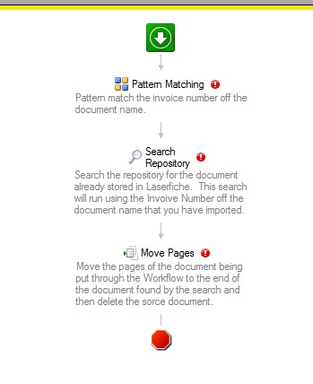

I'd agree with Matt on Quick Fields.
The following would hinge on the PDF documents being named the invoice number or something else that is unique and that is on the already existing invoice documentation in Laserfiche.
1.  Use Universal Capture Engine in Quick Fields to grab the PDF's out of your folder.  This can convert them to tiff.
2.  The Quick Fields session would be set to keep their same name (invoice number) and send them to a generic "incoming invoices " folder.
3.  Workflow would monitor this folder for document creation (trigger).
4.  The workflow would simply read the document name (invoice number) and then run a Search Repository.  Search for the invoice number (document name).  I am not sure how your existing invoices in Laserfiche are laid out but I am assuming that they are named the invoice number or have the invoice number in the metadata.  Build your search appropriately.
5.  Your search should return the existing invoice information document.
6.  Use the Move Pages to append the document to the end of the existing document (the search result).

If you do not have Quick Fields something simple you could do is to make your Workflow a Business Process.  This allows you to simply kick off the Workflow on whichever document you want.
Workflow:
1.  Pattern Match the invoice number off the document name.
2.  Run a search in Laserfiche for that invoice number.  Again this assumes that the documents you have in Laserfiche already contain that invoice number in the name or metadata.  You will do a Search Repository activity.
3.  The return results should be only one as the entry is unique (not sure but it should be).
4.  Then use the Move Entry activity to append it to the search result.
Starting the Workflow.
1.  Drag and drop the PDF's into Laserfiche.  You said they have the invoice number in the name along with other things.
2.  Select them all, generate their pages, then delete the electronic files (converting them all to tiff).  You can set your import options in the client to do this automatically on import if you wish.
3.  Then you can select them all, right-click Start Business Process, and select the Workflow.
Since you are running the Workflow on all documents each will kick through the Workflow one at a time.

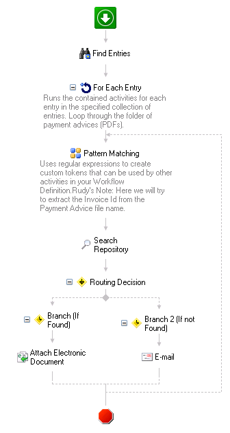

My Workflow logic would go something like this:
1. For each PDF file in the directory of the remote server. (Find Entries -> For Each Entry)
2. Extract the Invoice number from the name of the PDF file. (Pattern Match)
3. Find the Invoice in the Repository (Search Repository)
4. If found (Routing Decision? Branch 1)
5. Attach the PDF to the found document (Attach Electronic Document)
6. Else (Routing Decision? Branch 2)
7. Send email to the president (E-mail)
Does this look reasonable and/or correct?
Rudy
replied on March 14, 2014
Yes, that looks fine to me.  Users will just need to know to check the attachments since they are two different file types.  The only other thing you could inquire about is if your finance system can kick out tiffs instead of PDF's.  If it can then you can basically do the same thing but add them right to the existing pages instead of as an attachment.
