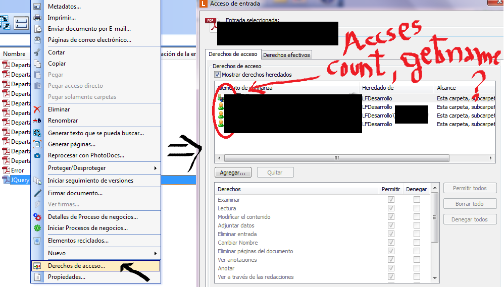

 Hi
Its possible get properties of right access of a document electronic LF via code sdk, repossitoryaccess,
workflow. Only see properties creator file but no a array of values de users with right acces.
Thanks for help. some tip ?
Adjunt files. (INo.png)
Hola que tal
Es posible acceder a las propiedades de un documento laserfiche via code. Ya que solamente
veo propiedades relativas a la creación del documento pero no relativo a quienes tienen acceso
al mismo, tal como se muestra en la imagen.
Gracias, por la ayuda.

replied on March 12, 2014
Thanks Miruna Babatie
for you help. You code is ok.
I was checking SDK (LFSO83Lib)
I do not know if it is the best or even correct way. I use C#
Imagine is another alternative. But, I find a method I do not documented in Laserfiche :
get_SecuredDomainAccountsEx(int preloadFlags)
method of LFDatabase.
What is preloadFlags?
I use preloadFlags=1, I was lucky , work fine, but could be 0, 1, etc.
