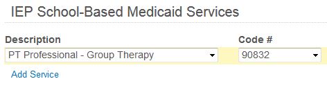

I'm not very good at doing custom javascript with tables so any help would be greatly appreciated.
I have a table on my form that includes a drop-down list (Description) that has specific values provided for each option in the list. I have a text field (Code #) in the table that I need to populate with the value that is selected from the drop-down list. This needs to happen for each row.

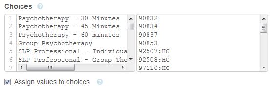

So, you want it to fill the appropriate code in based on what is selected in the description field? Do the values in the description field come from a lookup?
replied on February 27, 2014
A screenshot of the drop-down setup will probably help.
So when they select an item in the drop-down list, I need to populate the Code # text field with the value assigned to the option that was selected.

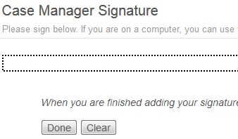

replied on February 28, 2014 Show version history
Something with the code that we added to populate the single line field is causing problems with the signature field. It shrinks the signature box when the code is added. If I remove the code it works correctly.
I found the problem. Below is the corrected code:
