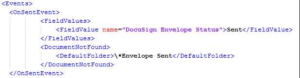

I came across this post whilst recently researching about and testing the DocuSign integration and with some help from others have been advised that you can use <OnSentEvent> to pass metadata values to Laserfiche when a DocuSign envelop is sent. This feature requires Web Import Services 9.0.2.755 or later - you can check the following hotfix to determine whether you are utilising a previous version.
For example, when I add below node to the config.xml file of DocuSignConnectService, field “DocuSign Envelop Status” will be marked as “Sent” when a document is sent to DocuSign.
Then Laserfiche repository users can identify these documents easily then by using columns views \ field search.
