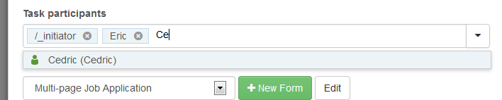

Using this method of assigning tasks, each participant will see the task in their My Tasks page until one of them completes it.
You don't need to use a delimiter when adding multiple task participants. While configuring your user task, in the Task participants field, enter the username or variable the task should be assigned to. An auto-suggested list will appear where you can select the correct user or variable. You can continue to add more participants to the task by repeating this process.
Please let me know if you have a different use case and I'll try to help. It is possible to do some cool stuff with intermediate timer events and task assignment.
