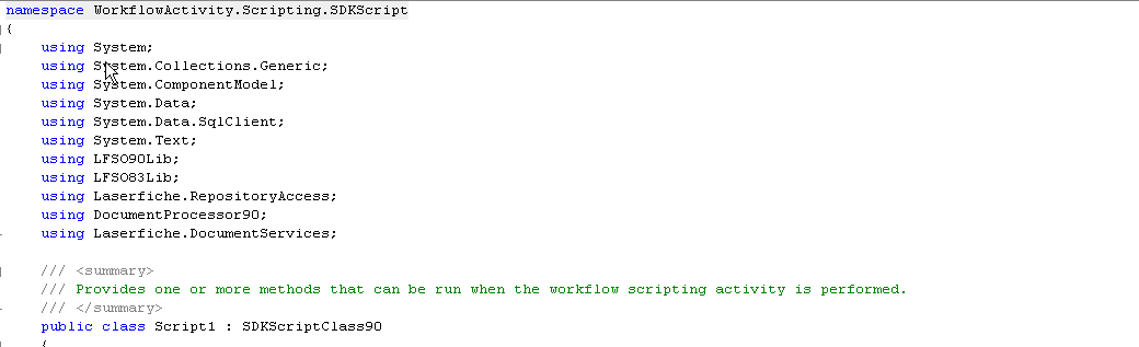

How would I go about doing that when both references appear the exact same? The reference in my script is:
using Laserfiche.RepositoryAccess;
That's how it looks with either 9.0 and 9.1

Can you post a screenshot of the References node in the script editor?
The "Entry Point not found" error is probably caused by the same issue discussed here.
replied on February 24, 2014
here is both
It looks like RA90 is being loaded because of your reference to DocumentServices 9.0.
Is there a reason why your script is using both LFSO/DocumentProcessor and RA/DocumentServices?
replied on February 25, 2014
Nope, I actually took out the DocumentProcessor references without any issues. It was just a remnant of the default references I guess.
I changed the reference of DocumentServices from 9.0 to 9.1 and now it's working and publishing just fine. Thank you.
