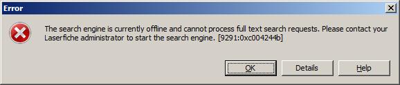

 Our Indexing Services is stopped we cannot able to restart kindly Give the solution

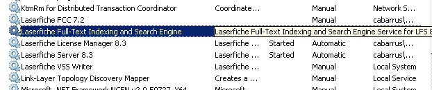

Make sure the Laserfiche Full-Text Indexing and Search Engine service is started on the server where search resides.
