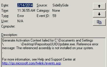

I am working with a Rio 8.3.1.663 customer who has restored a backup of their VM production server to a test VM server.  When they go to try to connect Workflow Subscriber (same one used by production) to a repository on the test server they get a message that it is already connected. When they try to attach it, since it says it is already connected, it does not show up as an option.  We believe this is because is because both production and test have the same uuid.  To update this we downloaded the 32bit RepositoryUUIDUpdater.exe from https://support.laserfiche.com/KB/1012907 and attempted to run from the LF test server (Server 2003 SP2) and it fails with the error:
The event viewer then shows:

Is that 32-bit Windows 2003? Can you check if Microsoft Visual C++ 2008 Redistributable x86 is installed? If not, you can find a copy here.

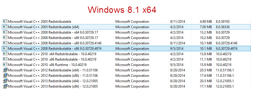

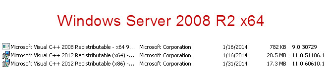

Miruna, I get the "side-by-side" error on 2008, 2012 and 8.1. I don't have a 2003 server to readily test this on. Here are screenshots of the MS C++ Redistributables on each machine I tested.

Let's pick the Windows 2008 machine, update VC++ runtime to the latest version then try again. Make sure you're running the utility with elevated rights.
replied on October 20, 2014
Miruna, thank you. The utility worked great once I ran your suggested update on the Windows 2008 machine.
