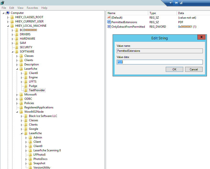

replied on December 15, 2014 Show version history
Should I create all 3? (i.e. PermittedExtensions - REG_SZ, BlockedExtensions - REG_SZ., OnlyExtractFromPermitted - DWORD. )
What will i put as value data for each or should i leave it blank?
Attached is a screenshot of my settings.
You don't have to create all 3. If you don't have the PermittedExtensions key, then LFFTS will attempt to extract text from any electronic documents. If you are adding PermittedExtensions to troubleshoot something, then you also want to set the OnlyExtractFromPermitted key as well.
And yes, just "pdf" is the correct value to have. You can add multiple extensions delimited by semi-colon.
