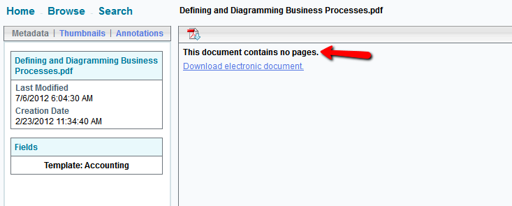

I have selected "Standard document display" to view the metadata when I am viewing a PDF. I now can open up my PDF and view the metadata, but I cannot view the image. Weblink is on 8.2.2. Has anyone seen this before?
replied on February 13, 2015 • Show version history
What do you mean by you "cannot view the image"? Do you see the following:
If so, that means that there are no Laserfiche image pages, only an electronic file (in this case, a PDF). See the help files for more information on what that means.
WebLink does not currently provide an embedded PDF viewer, so if you wish to simultaneously view the pages of the document and the metadata, you would need to generate image pages.
