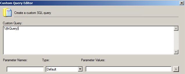

Assuming the queries return the same columns from the SELECT portion and use the same data source, what I would like is to be able to build the SQL query as a token, lets call the token %(tkQuery) for this, and then pass the final %(tkQuery) into the Custom Query activity as the entire query syntax. Then I would need to only setup the Custom Query activity, the error checking conditional statement, and the assign activity once for all current and future scenarios.

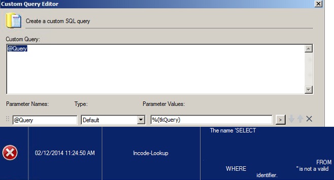

I've tried to put only a parameter in the entry box and then assign %(tkQuery) to that but it puts '' around it at runtime and thus SQL fails because of incorrect format.
I've tried various types of parameters and understand why what I am trying to accomplish fails with the way this activity currently functions.
Additionally, the custom query activity does not provide an obvious way to pass a token directly into the Custom Query entry box.  I've found that if I

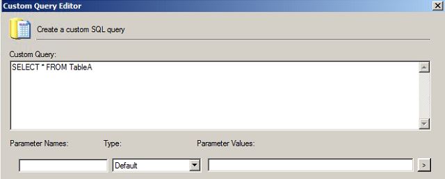

  1. put in a valid SQL query with all columns I need returned (assuming they are the same for all variations of the query token),
  2. run the test on the activity so it populates the query's column output tokens,
  3. and then replace the entire query with %(tkQuery),
that it will let me use a token as my query at runtime.  Obviously I can't test the custom query activity this way but at least it works at runtime for my issue.

The activity will not let you inject SQL queries through parameters. But it will still resolve tokens. So you can build the query as a token and use that the way you mentioned it above.

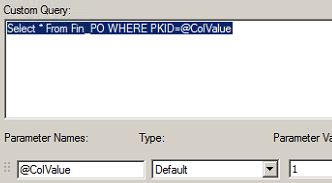

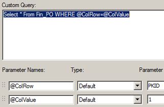

The Custom Query activity does not inherently allow you to use tokens in the query directly.  Additionally, it does not let you successfully pass column names as parameters, only the values of those columns can be passed as parameters.
  • This query returns a single row as it should
  • This same query passing the column name as a parameter returns 0 rows
It appears this activity treats parameters as it should in a SQL query by only allowing them to only replace a comparison value and not an actual portion of the statement.

  4. set the query in that activity to SELECT * FROM tblA
  5. use the test portion of the activity to populate the output column tokens
  6. replace the SELECT statement in the activity with my query token
  7. it wont test successfully in the activity but it will work correctly at runtime
