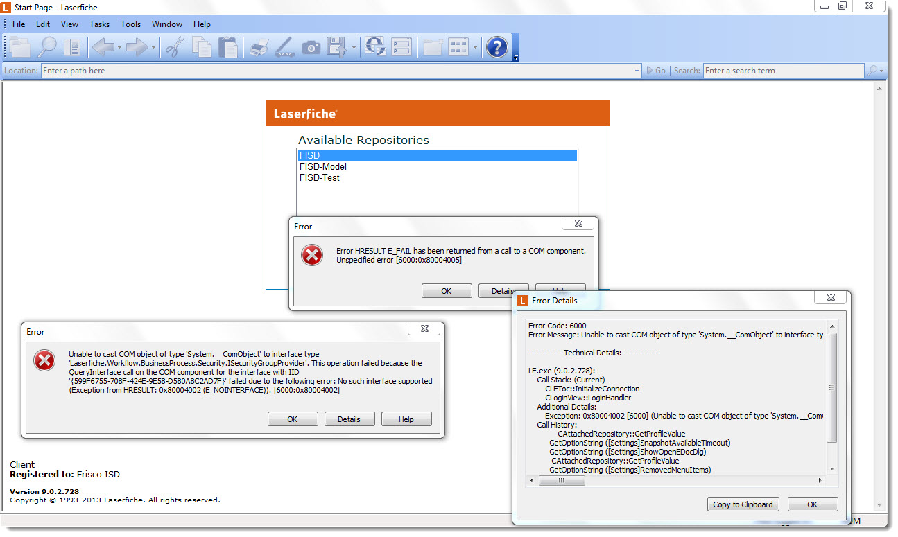

After upgrading our 9.0 Rio environment to 9.1 our 9.0.2 and 9.0.1 clients were getting the error below. The following products were upgraded to 9.1: Laserfiche Server, Workflow, Forms, WebAccess, LFTSC, AuditTrail. I didn't think there were compatibility issues between 9.0.x clients and a 9.1 repository. I upgraded the clients to 9.1 and the error is not longer occuring. Also, 9.0.3 clients were able to connect without errors as well. Is this a know compatibility issue or did something possibly go wrong in my 9.1 upgrade?
Error Code: 6000
Error Message: Unable to cast COM object of type 'System.__ComObject' to interface type 'Laserfiche.Workflow.BusinessProcess.Security.ISecurityGroupProvider'. This operation failed because the QueryInterface call on the COM component for the interface with IID '{599F6755-708F-424E-9E58-D580A8C2AD7F}' failed due to the following error: No such interface supported (Exception from HRESULT: 0x80004002 (E_NOINTERFACE)). [6000:0x80004002] (No such interface supported)
------------ Technical Details: ------------
LF.exe (9.0.2.728):
    Call Stack: (Current)
        CLFToc::InitializeConnection
        CLoginView::LoginHandler
    Additional Details:
        Exception: 0x80004002 [6000] (Unable to cast COM object of type 'System.__ComObject' to interface type 'Laserfiche.Workflow.BusinessProcess.Security.ISecurityGroupProvider'. This operation failed because the QueryInterface call on the COM component for the interface with IID '{599F6755-708F-424E-9E58-D580A8C2AD7F}' failed due to the following error: No such interface supported (Exception from HRESULT: 0x80004002 (E_NOINTERFACE)).) (CLFToc::InitializeConnection at lfToc.cpp:610)
    Call History:
              CAttachedRepository::GetProfileValue
          GetOptionString ([Settings]SnapshotAvailableTimeout)
          GetOptionString ([Settings]ShowOpenEDocDlg)
          GetOptionString ([Settings]RemovedMenuItems)
          GetOptionString ([Settings]FavoriteBusinessProcesses)

The issue is that the 9.0 Client contained a multi-threading/timing issue that rarely occurred, if at all, when connected to a 9.0 Server. However, due to changes in the 9.1 Server, it made this 9.0 Client bug more likely to occur unfortunately. This issue has been fixed in the 9.1 Client though.
With the complexity of the code, it would not be a good idea to try and fix this server side by catching the 9.0 Client usage scenario. The reason is that it may add more instability to the server and it may not even fully address the issue.
The proposed workarounds are as follows:
1. Upgrade to the 9.1 Client, at least for users who use the "Business Processes" feature.
2. If upgrading isn't an option and users do not use business processes, then create the attribute [Settings]EnableBusinessProcesses and set its value to No.
