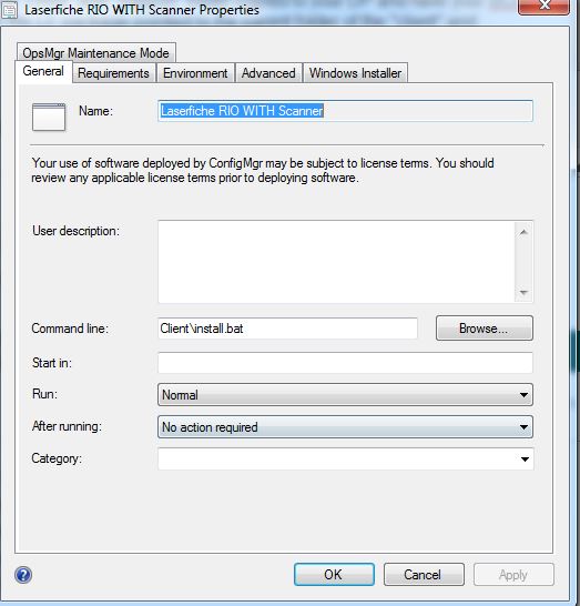

You should try and use "install.bat" with the following:
"\\path to install folder\laserfiche rio 9.0.2\client\setup.exe" -silent -iacceptlicenseagreement INSTALLLEVEL=300 LFSSADDLOCAL=ALL

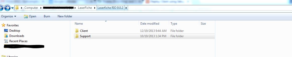

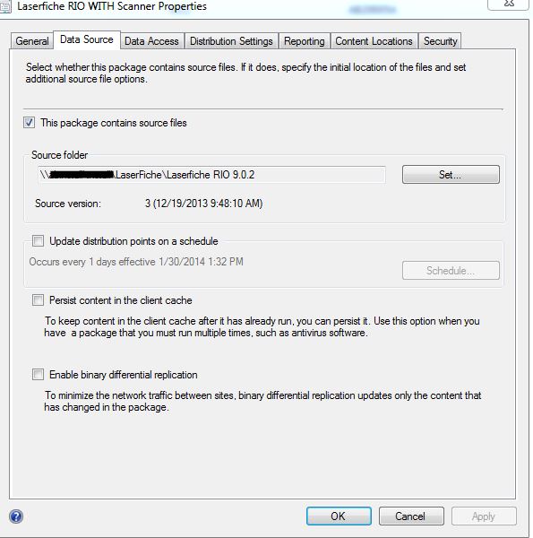

Make sure you have the "client" and "support" folder copied to your DP and have your SCCM 2012 source folder for the LF package pointed to the parent folder of the "client" and "support" folders.
SCCM 2012 :
Data Source "\\path to folder\Laserfiche\Laserfiche RIO 9.0.2\"
Program:  Client\install.bat

I'll check with our deployment team and see if they're individually added each of the folders or if they're pointing to the parent of the two.

Our deployment team did as suggested and deployed a single folder and within that folder it had both the Client and Support folder with the required MSIs. They still had issues as the client computer could not find the support folder MSIs.
