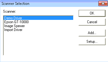

I tried the testappn.exe. The scanner was not listed in the list. I have attached a screenshot of what I see. What is interesting to me, is that when this dialog comes up in the LF Scan interface, there are a LOT more options for scanners. When trying to select a scanner for the testappn.exe, I do not see the same list as when choosing a scanner for Scan Connect in LF Scan.
I did try the KB article you mentioned. When I copied those files into the PIXTRAN folder, it prompted me to overwrite. They already existed in that folder. When I tried to configure Scan Connect, the scanner is still not showing up in the list.

replied on March 6, 2014
Uninstall ScanConnect, reboot, and reinstall. Note that ScanConnect 8.3 will actually install many drivers for various scanner models. However, if you don't see your scanner's driver and/or the list still only shows those same four scanners only, then follow the steps in KB 1011942 again. If that doesn't address your issue, then please open a case with support.
