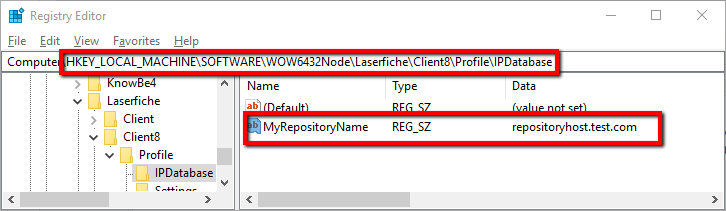

replied on December 23, 2019
To add a repository machine-wide (I tested this on the 10.4 client), create they key HKEY_LOCAL_MACHINE\SOFTWARE\WOW6432Node\Laserfiche\Client8\Profile\IPDatabase and create a REG_SZ with the repository name and LFS host:
The "Thunk" setting for scanning the network does not read from HKLM, but if you set the above value the repository will show up in the list and be selected by default.
