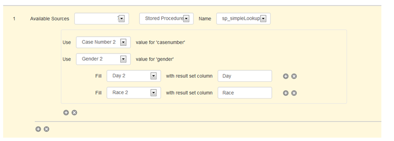

replied on March 27, 2014
It could be that the result set column names used in your stored procedure lookup rule aren't correct. Here's my lookup rule:
Here are my result set columns:

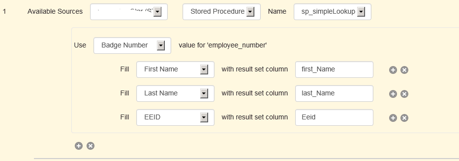

Below is the set-up:
result sets column:

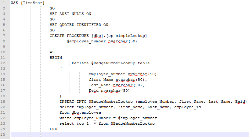

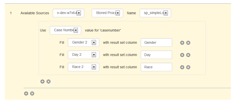

I can't really say without seeing the stored procedure you wrote what's wrong. If that doesn't work, 9.1.1 is available and offers the flag that will disable the auto-suggest behavior.
replied on March 27, 2014 • Show version history
here is the Stored procedure:
