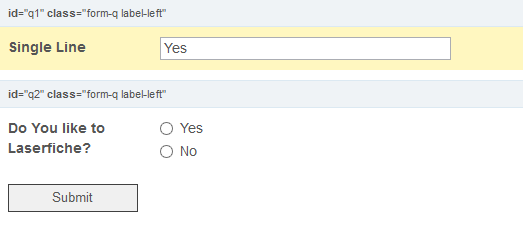

I want to take a field that will be hidden by CSS and filled during a Lookup, and use that value to determine what option in a radio field should be automatically selected.
I cannot seem to reference it properly, does anyone have any advice or can help with this problem?

so if i need to select field 1, it's ID is q1, should i say it's '#q1' or 'q1'?

Maybe I gave too much information at first and now it's confusing.
Say I have a field, it says Yes. That is also the value of the radio button I want selected. How do I take that field value of "Yes" and set the "Yes" option in a "yes" or "no" radio button options

This should get you started. This code uses a radio button field (with the radio css class) and a single line field (with the filledField css class)
1$(document).ready(function () {
2
3  $('.filledField input').blur(function () {
4    var value = $(this).val();
5    $('.radio').find($('input[value="' + value + '"]')).attr('checked', true);
6  });
7});
Currently the code runs when the user leaves the single line field.

1var radiovalue=$('#q1').val(); // gets value sets it to a variable named radiovalue
2
3
4$('input').val(yes); //sets value of the input box to the radio button
#q1 would be the id of the text field
I think that should work.

replied on January 27, 2014
Thanks for your help, this is going to make my form very nice
