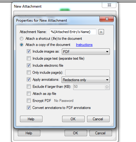

replied on January 24, 2014
Have you made sure that in the properties for the attachment "Include Electronic file" is clicked?
Thank you, Chris. Unfortunately, I've already made sure that those options are checked, and the PDF itself is small, only 1.74 MB. And when I attempt to grab it on its own, it still isn't captured. Also, I'm compressing the files to be sent...

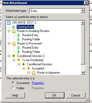

This is actually how it's configured.
