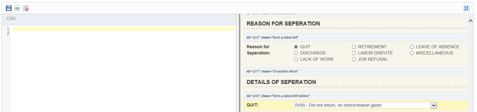

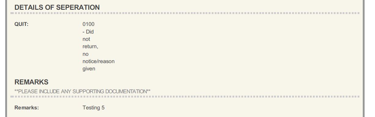

I have a HR form and one of my options is a dropdown box that has a few long entries.  I save the output form to a pdf for record keeping however when these drop down items are chosen it looks bad on the pdf.  I am attaching an example.
is there some way that I can fix this, maybe css coding?

When Forms converts fields to read-only, it changes how they are displayed (e.g. a the selection for a drop-down is placed inside a <div> when it is read-only. You can change how these fields are displayed in read-only mode (or when printed as a PDF) but you'll need to make sure you're targeting the right element with your CSS.
The Forms team is aware of this issue and will address it in a future release.

Here is scripting side, I have tried a few simple css commands #q18 input ..... but they didn't help in the end.  it looks correct on the form but the pdf output squishes it together.

I'm having trouble reproducing this issue. What is the drop-down field's width set to on the Edit page? is the field read-only? What are the other values for the field?
replied on January 24, 2014
First its a hidden Dropdown based on the radio button selection.  when you select Quit as the radio button option it shows a drop down list the label on the list is Quit and the the dropdown is set to x-large.  Its not read-only, the choices are long however for example: "0100 - Did not return, no notice/reason given"
