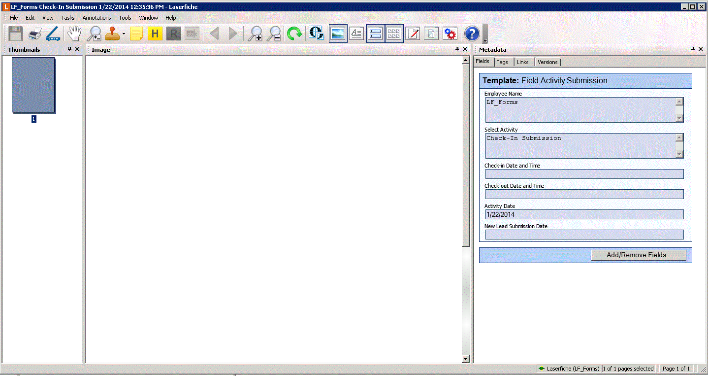

I changed my connection to my forms server to ssl and once I did that submitted forms gets saved as blank pages.
I have laserfiche and forms server on different server.   I have turned on the IIS and forms to connect via port 443 (https://), now I am able to connect to the forms and submit jobs using https no problem.
Now I only have a blank page in my repository.   My laserfiche is not configure for https connect and under forms configuration SS for Laserfiche repository is not checked.

Are you using forms 9.1 or 9.0? Could you please show me what the blank page saved in LF repository look like? Thanks!

I am using forms 9.1 but the laserfiche is 9.0.1.    Before enabling ssl I had no problem.  Aslo, when I enable to save history I get another page that one is blank too..   please see attached file.

replied on January 23, 2014
Thanks for the help guys.  That was right on, I changed the http to https on Form server configuration and it worked.....
