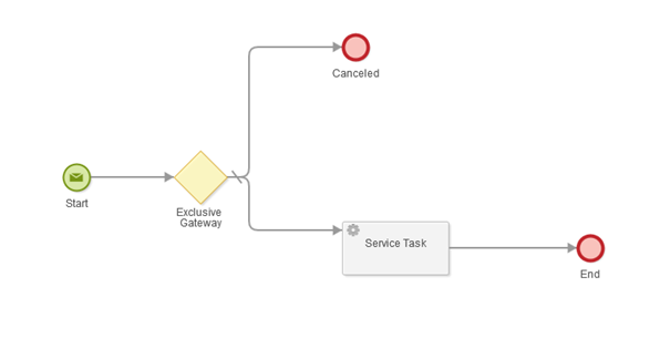

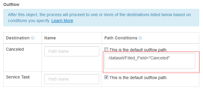

Here's the process model:
The exclusive gateway is configured to route the process to the "Canceled" end event when the filled field's value is "Canceled"
