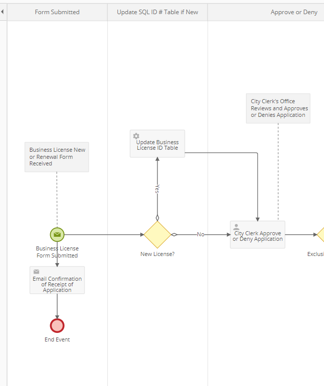

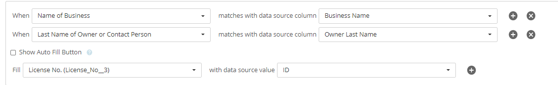

After the fact, I found this very much appreciated post, and I wanted to add screen shots in the event it provided additional info for someone else out there.
I Created a small table in MSSQL Management Studio that would generate unique license numbers (via the ID column).  I had forms use a Workflow Service Task to start a workflow to populate the table with very basic info (Names below are fictitious).  The ID column generates a unique number (increases by 1) for each line as forms are submitted.
I then created a Lookup Rule that pulled info from the SQL DB Table ID field back into the License number field in the Form.
The initial post even though it is 6 years old, was very helpful to me once I understood what I was doing.  Hope the addition of screenshots help someone too.
