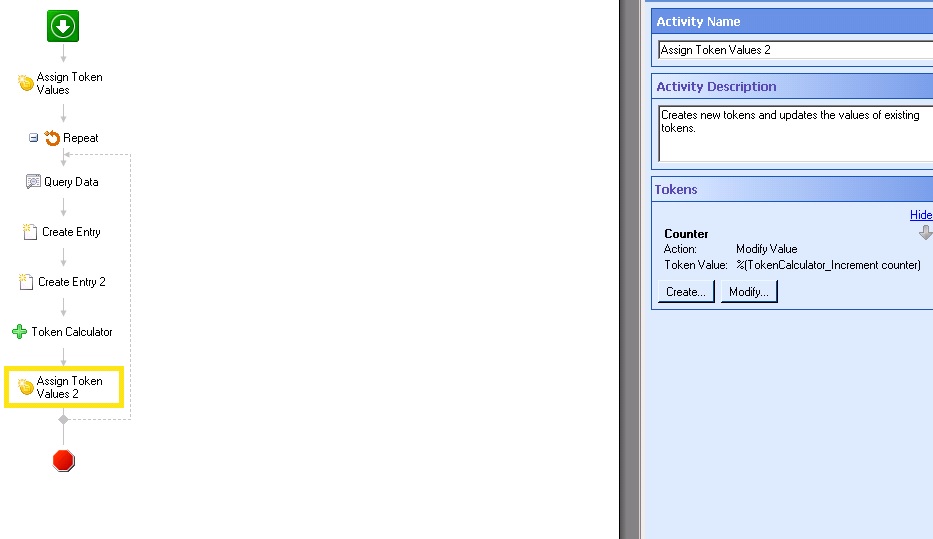

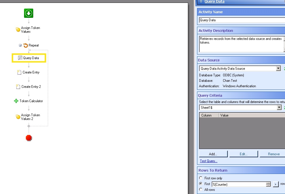

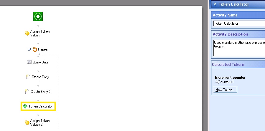

Edit:  I have uploaded a few pics.  Maybe I am going about it the wrong way but in summary I have the following.
I create a counter token and assign it the value of 1.
Then I Query Data and only retrieve the row of the according to the value of the counter token.
Then I create two entries.
Then I increment the counter by 1.
Then I assign the counter token to be the incremented value.
All of that besides the first creation of the counter variable is inside a Repeat.  Just for testing the condition on the repeat is just if %(Counter) is less than 100.  Don't need to do them all for testing.
I am able to get the first row done.  The two folders create but it then does not move on to the second row of the xls.

You have not read the setting you are using. It is set to grab the first [Number from counter] rows. When you increment the counter, you are actually telling it to grab two rows, then three rows, then four, and so on. The first row in that Query will always be the same in these cases.
To remedy this, try having it grab all rows, remove the 'Repeat' activity, then use the "For Each Row" activity and have the 'Create Entry' activities set to use the "ForEachRow_[ColumnName]" Token to have it create the folders based on the current value you are referring to in that row.
The token name may be wrong in my example, but it sounds like you are using the first result in your create entry activities and not the current value you get from using the For Each Row activity.
replied on January 15, 2014
That was it.  I actually had two different versions, one being a For Each and one being a Repeat.  Was trying many different things but was using the Query Data activity to fill in my info instead of the For Each.
Thank you for the response.  Got things working as needed and appreciate it.
