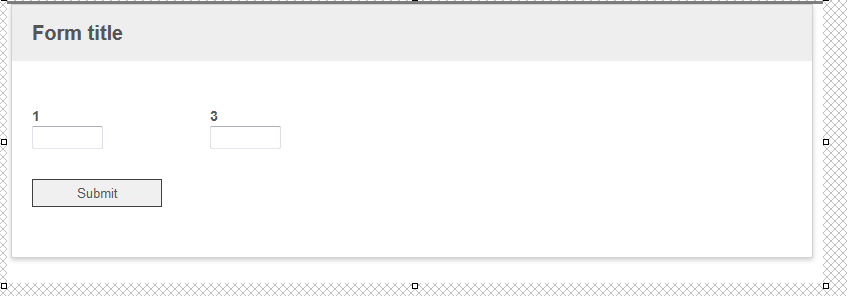

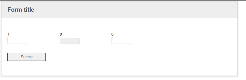

When you specify a layout for fields, like in-line display, rules disable those fields instead of hiding them, because hiding them would change the layout. Take the following example, where there are three fields displayed side-by-side.
The second field is hidden by a field rule but appears disabled so the layout structure stays intact. Here's what it looks like when that field is hidden:
Another example of this is hiding fields within tables. If you completely hide a field in a table, it throws the table's layout off. In order to prevent that, the field is disabled instead of hidden. See the discussion in this question for more information and some solutions you can use.
