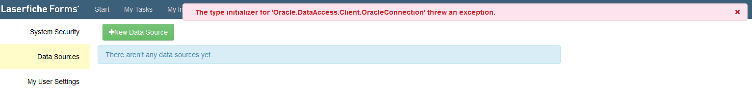

Forms 9.1.0.1441 - When trying to connect to an Oracle Database I am receiving the following error message: "The type initializer for 'Oracle.DataAccess.Client.OracleConnection' threw an exception.". Where can I find more information about this error?

Do you have Oracle Data Access Components installed on the Forms server?
replied on January 10, 2014
No I do not. Do I just need to install the ODAC 12c Release 2 and Oracle Developer Tools for Visual Studio (12.1.0.1.2) listed on that page on the Forms server?
replied on January 10, 2014 • Show version history
I just installed the Oracle Data Access Components and tried it again and still receive the same message.
I am not very familiar with Oracle, so any details you can give me would be great.
There should be a corresponding message with more information in the Windows application log. Can you post its contents here?
There is no message corresponding with the problem.
Just double checked that it didn't have to do with our firewall and it does not.
I have noticed that if I go to create a new ODBC Data Source connection that it does not list any Oracle drivers. I have restarted the server to see if that would resolve the issue, but it did not.
Can you have your VAR open a support case and we'll go from there. In the meantime, I'll see what we can do about getting the setup for Oracle data sources documented in more detail.

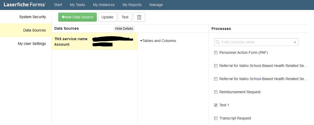

I had installed the 32 bit version, but was running a 64 bit server. I installed the 64 bit version and the error went away. Now when I go into Forms and setup the Data Source it has the Oracle database, but when I look at Tables and Columns nothing shows up. Also, when I select which Process to have access to it, there is no way to save the setting.

replied on May 8, 2014
Did you ever find out what was causing the tables and columns to not show up?  I'm in the same situation.  The data source has been set up but none of the tables/columns are showing up but I know the account has access because I use the same account to do look-ups for workflow and Quick Fields.
