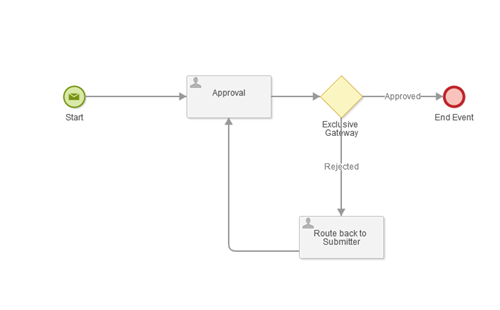

It seems like you're asking, "How can I route submissions back to a user so they can edit and resubmit them."
Assuming that these are named users (or authenticated participants in Forms 9.1), the most straightforward way to do this is within the Process Modeler. You'd just assign a user task to the process initiator with the form used in the message start event.

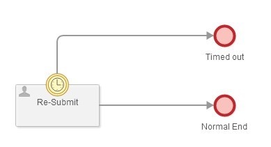

If the users are named user or authenticated user, you can use the configuration like Eric suggested, and attach a timer event to it. The timer event will wait a pre-defined amount of time period, and if the submitter does not respond within this time frame, you can have the timer event connect to an end event so the entire process ends there. Therefore you will not have any process that never terminates, nor will you have any duplicate instances for the same request.
Generally it's not recommended to use URL to pass binary data into a form. The timer event is available in 9.1 so the customer will need to upgrade.
replied on January 10, 2014 Show version history
Please check out the following screenshot, it shows the sample how to use the new Timer Boundary Event to terminate the process if the re-submission is not needed.
