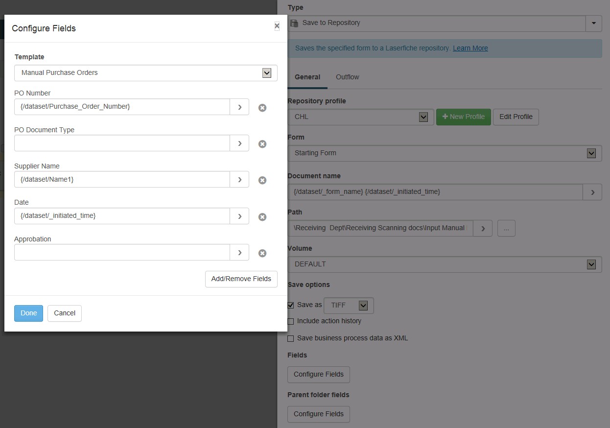

Got the same issue and cannot make it work and I have forms version 9.1.1
Any ideas how to fix this issue.
replied on June 18, 2014
Are you using the "Save to Laserfiche" option under the "Publish" tab or are you using the "Save to Repository" service task in the business process modeler?
replied on June 19, 2014
I am using it in the business process modeler to send the forms in laserfiche as a document with a Template and metadata attached to it.
but the file when saves in laserfiche, does not have Template and metadada

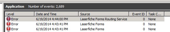

Did you see anything reported in the application event log on the Forms server? Maybe you're running into the issue described in KB 1013481.
Log Name:      Application
Well I just try it again, If I do it directly on the forms server, it works but if I try to fill the forms from another pc throught the Forms web site I got the issue and in the event viewer I have 3 error line
first event viewer error
second one
and finally get this one

Another operation on which this operation depends failed. [9054]
Bad field value. [9017]
Stack trace:    at Laserfiche.RepositoryAccess.EntryInfo.Save()
   at Laserfiche.Forms.CommonUtils.LFHelper.SetValueToTemplateField(EntryInfo lfDoc, String template, FieldValueCollection fvs)
Event Xml:
<Event xmlns="http://schemas.microsoft.com/win/2004/08/events/event">
  <System>
    <Provider Name="Laserfiche Forms Routing Service" />
    <EventID Qualifiers="0">0</EventID>
    <Level>2</Level>
    <Task>0</Task>
    <Keywords>0x80000000000000</Keywords>
    <TimeCreated SystemTime="2014-06-19T20:44:00.000000000Z" />
    <EventRecordID>2689</EventRecordID>
    <Channel>Application</Channel>
    <Computer>GammaHV.cedres.canadianhelicopters.ca</Computer>
    <Security />
  </System>
  <EventData>
    <Data>6/19/2014 8:44:00 PM
Bad field value ('PO Number'): Another operation on which this operation depends failed. [9054]
Bad field value ('PO Document Type'): Another operation on which this operation depends failed. [9054]
Bad field value ('Supplier Name'): Another operation on which this operation depends failed. [9054]
Bad field value ('Date'): Bad field value. [9017]
Bad field value ('Approbation'): Another operation on which this operation depends failed. [9054]
Message: Multistatus response. [9039]
</Data>
  </EventData>
</Event>

It's reporting a problem with the Date field. What date format is used when submitting the form from the server? What date format is used from the other PC? Is there a difference, i.e. MDY vs DMY, etc? What if you try a generic date such as 1/1/2014?
replied on June 20, 2014
Well it should not matter a date is a date ?
I format is on the forms to display yyyy-MM-dd (well cannot customize it , choice from forms date format)
Date from pc to other pc in the background should not matter because it should be the whole date.
I will get a try to use the same regional setting for date and time if it works
I just tried it and I set the reginal setting to all usa and the shortdate to yyyy-MM-dd
and got the same issue
