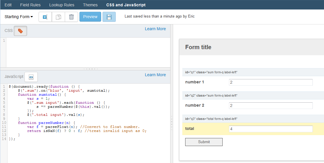

Did you modify the code at all? How many fields are you multiplying together? Here's a screenshot of the setup mentioned in the example:

Update,
I got the same problem as Armando Ontiveros  where the input multiplies itself. That only happens when you use the number or currency input field. It woks fine when you use this code in the "single line" input field
replied on June 11, 2015
The issue Armando reported is explained in this thread. The values in the input are getting doubled before they run through the calculation.
Instead of using
$('.sum input').each(function () {
you would use
$('.sum input').filter(':visible').each(function () {
