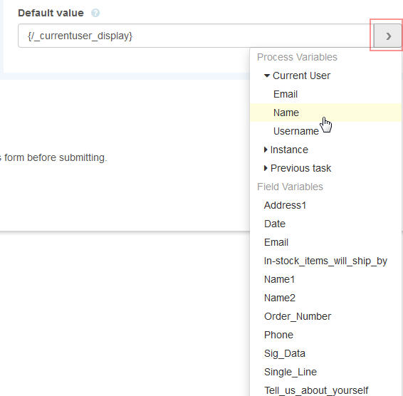

In the upcoming 9.1 version of Forms, you'll have access to some process variables within the Form Designer, including the process initiator, so you'll be able to set the default value or help text for a field to be the process initiator, current user, etc. Then, you could create a simple page rule based on the initiator or user currently viewing the form. Coupled with the new stored procedure functionality for lookup rules, the new variables in the Form Designer are pretty exciting!

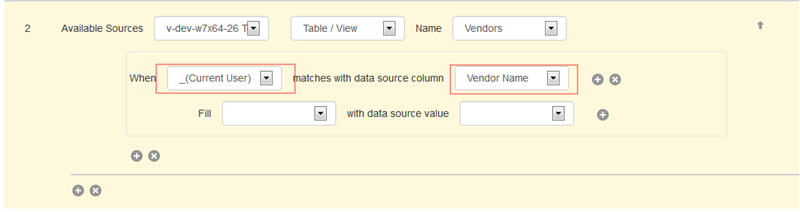

You can create lookup rules that directly use the current user, for example:
However, to hide or show fields based on the current user or process initiator, you'd insert the process initiator or current user variable into a field, and then create a field rule using that field.
In this screenshot you can see the Insert Variable button, and the list of variables you can use as the default value for the field.

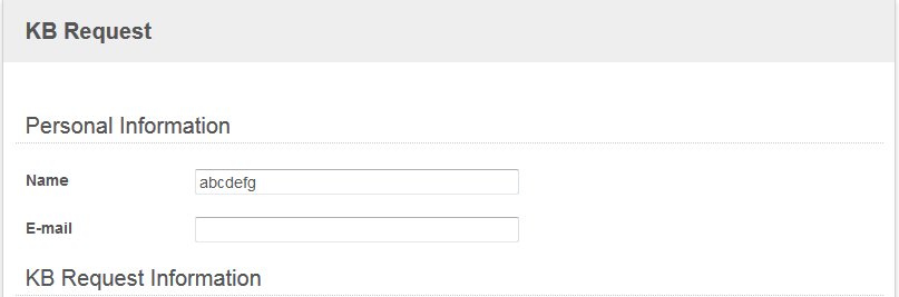

I'm interested to hear a specific use-case for this. You could try appending a hash to the URL and then parsing the URL with JavaScript.
For example:
baseURL#abcdefg
some code:
var testVal = window.location.href.match(/#.*/)[0].substring(1);
  $('#q1 input').val(testVal);
The result:

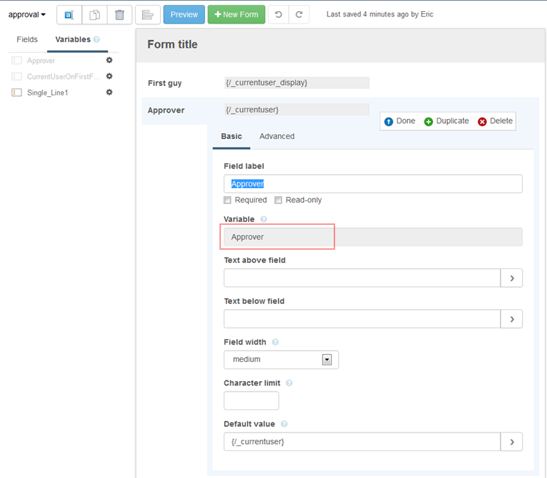

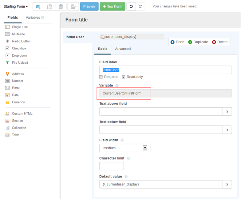

I have another question on this topic. The field is populating and works properly if user logs in and submits the form. If the form includes Approval process, the email sent to the approval destination (another user) with the link to the form to complete the process. New user accesses the form but {/_currentuser} inherits value from the initial process.... Is there any other parameter we can use to distinguish the current user name in this case?
Thank you
replied on February 12, 2014
One way you can do this is by creating a separate form for the approval task. You'd add the fields from the starting form to this new form as variables, and add a new field with the {/_currentuser} variable as its default value.
Here's an example, where I've got an initial form that captures the first user, and then a second form used for the approval step.
After we create the first form, we take note of the variable for the field that's capturing the initial user. We then add that to the second form along with a new field that targets the new form's current user.

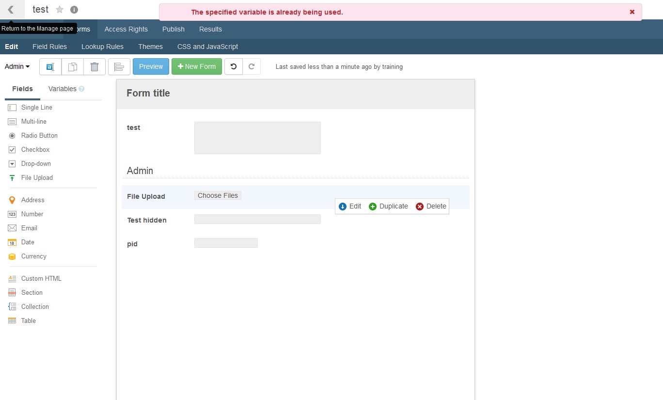

Hi Eric,
I tried - it does not accept variable, saying specified variable already in use.
replied on February 13, 2014
Can you post a screenshot of this error message and when it occurs?
replied on February 14, 2014
Hi Eric,
That's interesting. The error happens in this scenario:
1. Form created without File Upload field;
2. Copy the form to create a second form;
3. Added File Upload field on to the first form;
4. Adding File Upload field in to the second form with the variable name from the first form created error below.
It does not if File Upload Field is already in place prior to copying form.
Putting this just for information only, after conversation with the customer it was decided to use a script based on your code earlier.
The error you're describing happened because you made a copy of the form. The copy of the form already had the file upload field on it, so you couldn't add the variable for it again.

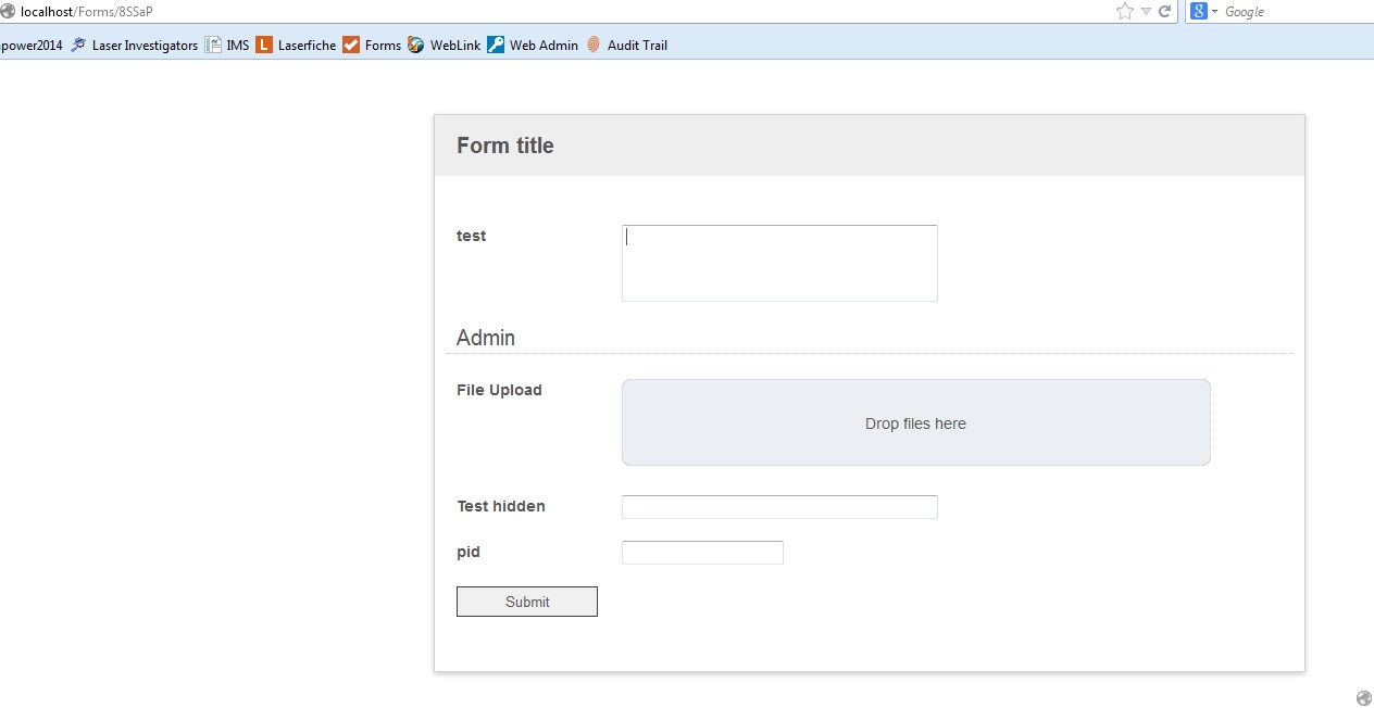

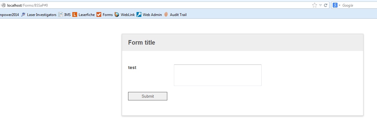

Hi Eric,
It is not an error per say, form's URL: http://localhost/Forms/8SSaP,
Public users use http://localhost/Forms/8SSaP#0, and it hides Admin part (screen shot 1)
however if they just delete last two characters in URL to return to the original one
(http://localhost/Forms/8SSaP) Admin section appears:
(screen shot 2)
Using this script
  if (window.location.href.match(/#.*/)[0].substring(1) == "0") {
    $("#q3").hide();
If you're trying to hide those fields on the initial submission but have them visible for future approval tasks, you could go a different route:
$(document).ready( function() {
if($('input[name="routingResumeId"]').val() =="") {
$("#q3").addClass('hidden');
Using this method, the person submitting the form wouldn't be able to see these fields and you wouldn't have to use the modified URL workaround you're using.
