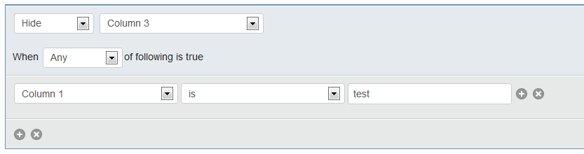

When field rules are set to show/hide fields within a particular table row, the behavior is a little different. For example, if I have a rule like this:
When the value in Column 1 is "test," the field in Column 3 is disabled. It is still visible, but I cannot enter any information in it.
Actually hiding the field is sort of tricky because it may need to appear for other rows. If you'd like a more visual indication that the field is disabled for the row, you can achieve that with JavaScript. If you let me know what you have in mind, I can probably give you the code to make it work.

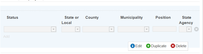

What I'm trying to do is I have Fields in a Table.  They are as follows:
Status, State or Local, County, Municipality, Position, State Agency
What I'd like to have happen is if they chose "State" from the drop down list, then County, Municipality, and Position are hidden and only State Agency applies.   On the other hand, if they chose "Local" from the drop down list, then I want State Agency hidden.  This is a repeatable table.
