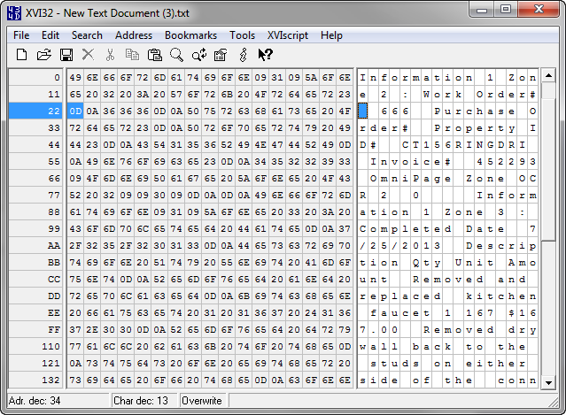

I have a multiline ZOCR in QF that looks like
Information    1    Zone 2 : Work Order#
666
There is a CR/LF x0Dx0A after the #
I am trying to get a reg exp to pick out the 666 but can not get it to get beyond the CR/LF  The expression is Order#\s*(d+).  As I type this in the test field of QF the result value is seen as I type the exp...Order#\s* all good to this point, but when I type 6 it will not display.

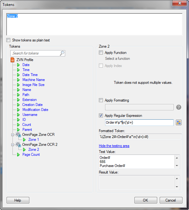

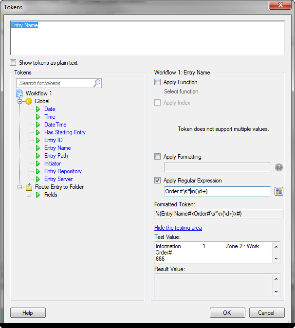

I thank you both for your quick response.  Unfortunately neither worked.  Logic says and another Reg Editor I used says Order#\s*(\d+) works, but as you can see here it does not.  I tried ther \D?\D? to no avail.  The problem may be that I am not using a token.  As you can see I am RE a field directly.  Is this a problem?  I will go back and create a token but this seems like an extra step.  Also, this does NOT work in WF either.  I tried to test it by putting a Routing Activity into a new WF and then opened the Token Dialog box for a Date field (looks just like the attached screens).

I see two issues.
In the first screenshot, you are having both the \n and \s* which is unnecessary. You want to at least add a '?' to the end of either or both of those and you may have better results.

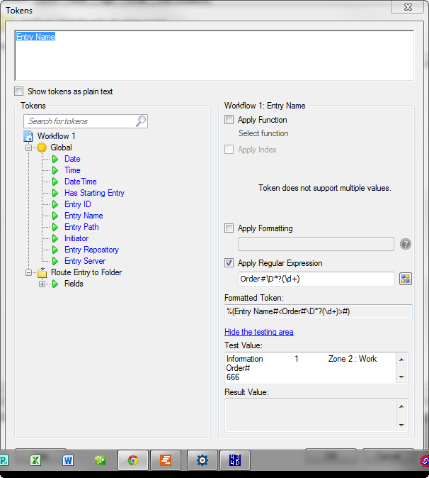

The second screenshot seems to be that you have removed a space between 'Order' and '#' and that is a potential reason for the unaccepted pattern match. Try '\D*?' instead of the '\D?\D?' I suggest and I think you will also get better results.
replied on November 12, 2013
Like I said above, Order#\s*(\d+) can't possibly work because it's not accounting for newline characters.
I've used the text file you attached to test the pattern and it worked. You can try specifying that there could be more than one newline character in between the 2 lines: Order#\s*\n*(\d+). You could also try \r\n for the newline character (I don't expect that to work because OCR uses \n, but it's worth a try in case you're running into something weird).

I was using Workflow Designer actually, not Quick Fields to test this functionality.
You may want to make the Zone OCR into a multi-value field and used the 2nd index of the value to get the information you wanted.
Kenneth,
I was given two solutions, so was trying both.  There is no space between Order & #.  It looks that way, but is it not there.  I am certain of all the characters as can be seen in this attachment.  Also attached is a WF token editor where \D*? does not work.  I have a rebooted machine and no Virus scanner on.  I can't use a multi index field as I have a number of these to fill in and I can not always be sure it will be the 2nd or 3rd row.  Thanks for any other suggestions you might have.

Oddly, I also could not get this to work when inside a regular expression editor in the token dialog box. I then tried the original proposed solution you had and got a hit
I used the exact text from the txt file you provided and you are indeed correct about some weird character being inside it but I think this may fall back on how different way you modify a token will act differently in Quick Fields or Workflow designer.

So can you tell me why \x0D\0A does not work?  Tks
replied on November 13, 2013
Oh, I see, sorry about that, not sure how I missed it. They're not being read as a group (like i mentioned, regex is very literal). They're read as "\x" and other characters. You need to wrap them in a non-capturing group, "(?:)", to get them to be considered together.
Order#(?:\x0a)*(\d+)
