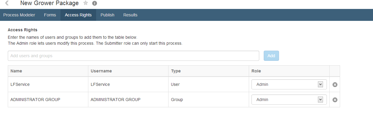

Hi Eric,
In the Access Rights page, there doesn't seem to be a place to set it to "Public". Here is what I see

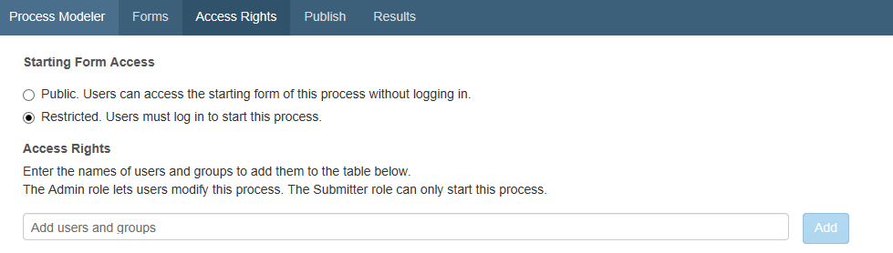

replied on December 24, 2013
Hi Doug,
1. Which browser you use to access this page?
2. Can you try Ctrl + F5 to reload this page?
See the correct display in attachment.
Access Right.PNG (16.45 KB)
replied on December 26, 2013
Do you have the Public Portal Add-on for Forms? What you're seeing is what users without the add-on see.
